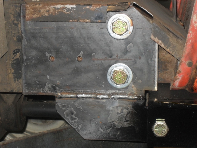

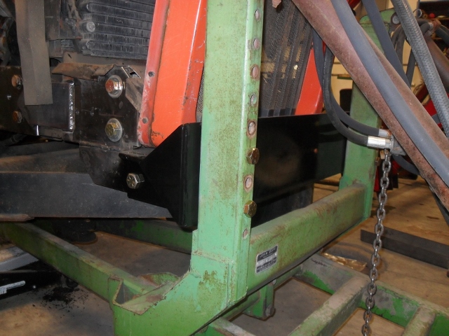

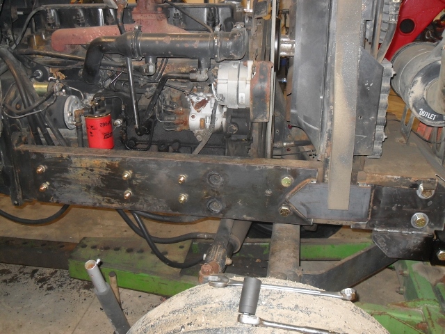

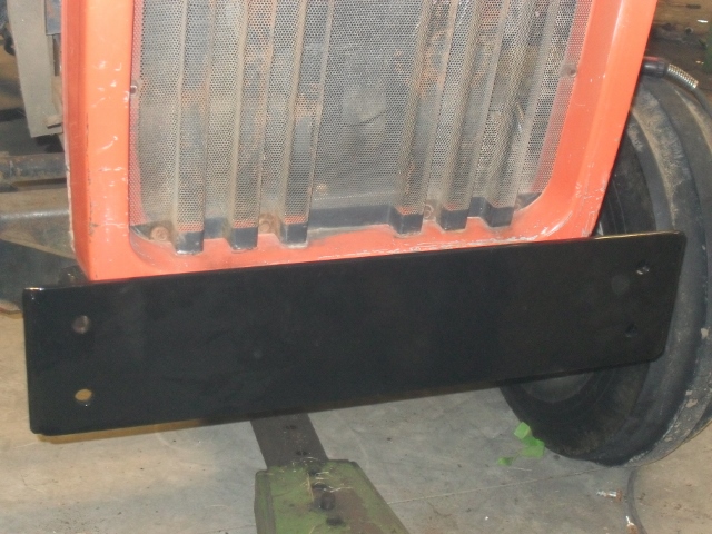

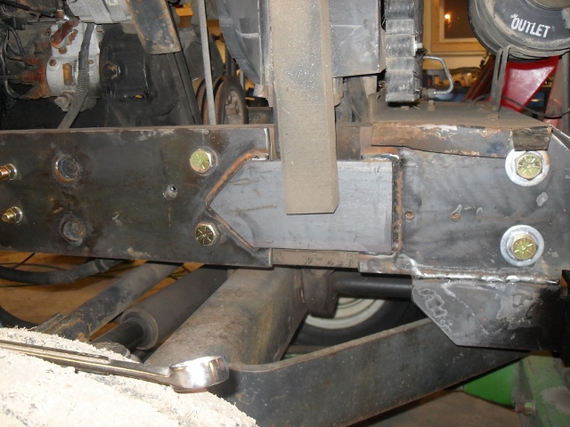

I know there are some people who don't like front mount blades on here and I totally respect their opinions. In the sandhills of Nebraska it's pretty tough to find a ranch or farm that doesn't have one and they are mounted on all colors of tractors. My cousin has a 12' blade that he has run on a 7040 for 25 years and has had no ill effect to the tractor, after he mounted his blade like in these pictures.
He first mounted it under the frontend where your weight bracket attaches to the cast. The problem with that was the frame would flex a little at the front engine mount bolts and took the gaskets out of the front of the engine. He fixed the gaskets and ran 4'' plate down the frame and never had any trouble again. I overbuild everything so I used 1/2'' thick plate by 8'' wide, and made it in 3 pieces that can be unbolted at any time.

looks good.......... nice welding job.

yeah...you do nice iron work! that should work! and like you said, i'm one that never really liked them on the front too...because of the frame flex. I've seen a lot of broken tractors because of them. but again...a lot were prolly operator errors! lets see the whole tractor and blade pics!

looks like it does all the pushing from the back of the tractor lots of blades around here some good mounting jobs some not so good same with loaders on 40 hp tractors moving 1/2 ton bales.   looks pretty good and sould last just fine if your not pushing scrapers and dozing boulders

You guy's are to kind, after I put that picture up I actually thought that one weld looked like chit.LOL I will post some final pictures  in a couple day's. I'm to computer illiterate to get them up on my own. I'll show you my last welding project.

Post Options Post Options   Thanks (0) Thanks(0)   Quote DIESEL Quote  Post ReplyReply Direct Link To This Post Posted: 04 Jan 2017 at 6:48am
I'll paint the mounts black right away and maybe this summer I can get the dozer painted black. The green can't stay!
